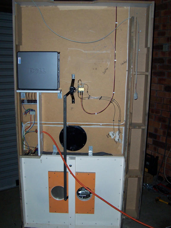

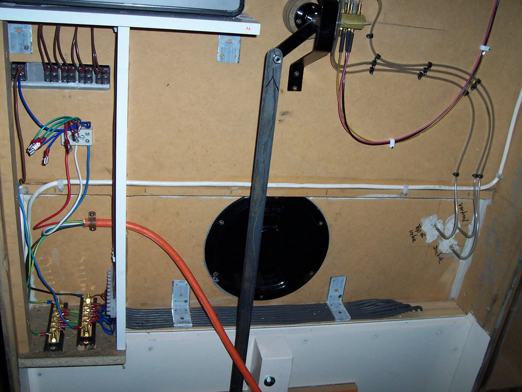

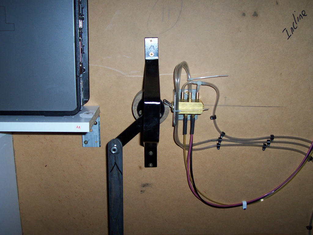

This was built a VERY long time a go.
Long before the PTS bench was ever even thought of, back when there was really nothing really good out there to copy.

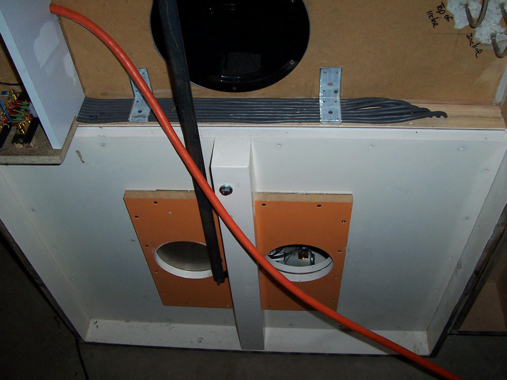

Just a few of my own crazy ideas at the time, like having two test holes (one always sucks the other always blows).
Nobody else does it that way, but its a very simple way of testing without having to reverse the airflow direction within the bench which I could see no simple way of doing back then.
Also known as the infamous "Warpspeed" on some other Forums.

Looks very clean & professionally executed very nice workmanship .
Do you still use this flow bench ? Looks like its built to last .

I still have a bench with a very large vertical rotating turret, but it always flows in the same direction (having two test holes).
Sealing the turret was never a problem, direct air pressure plus a big spring does that.
