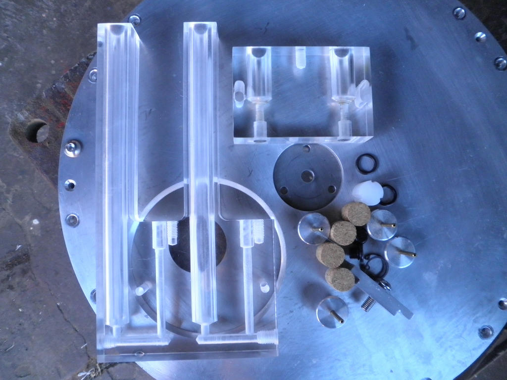

The thing has turned to sh!t, so I'm pretty much over it - hence why there is no text with the pics -.
The FP-1 isn't good enough to do the pre head leakage test with a large orifice, so I asked PTS DM users to do a 30 sec test to prove that it can do what I want before I bought it. No one would help me so the information never came, and I had to go back to multiple orifice disk.
The guy making the disk doesn't understand what I want, so it didn't work. I said the disk had to be totally flat, but he gets them laser cut so they are warped. There is so much warp that the disk presses on the Alum so hard when you spin it, it gauls the Alum resulting in disk jam when the clearance is only 0.004". After checking we found out the Alum plates are warped to start with, the machined Alum plate wasn't machined flat, and the disk is warped, so I'm changing everything to SF design where the disk is spring loaded down without the top plate.
The manometer will be easy because I'm going to mark the levels using the DM, and then make a ruler to suit.

I never wanted the manometer, but the owner insisted, so I made that one just for show. It will never be used for any actual accurate measuring, since there is a graphical manometer in the program.
I'm just going the mark the fluid level at rest, 28", and 50", and fudge a scale.
If you look at the old pics and the new pics, you can see that owner added a whole side panel to the cabinet just for the manometer when he took it to get it laminated. I couldn't kill it after that, even though I stated it many times before hand that it wasn't necessary.
