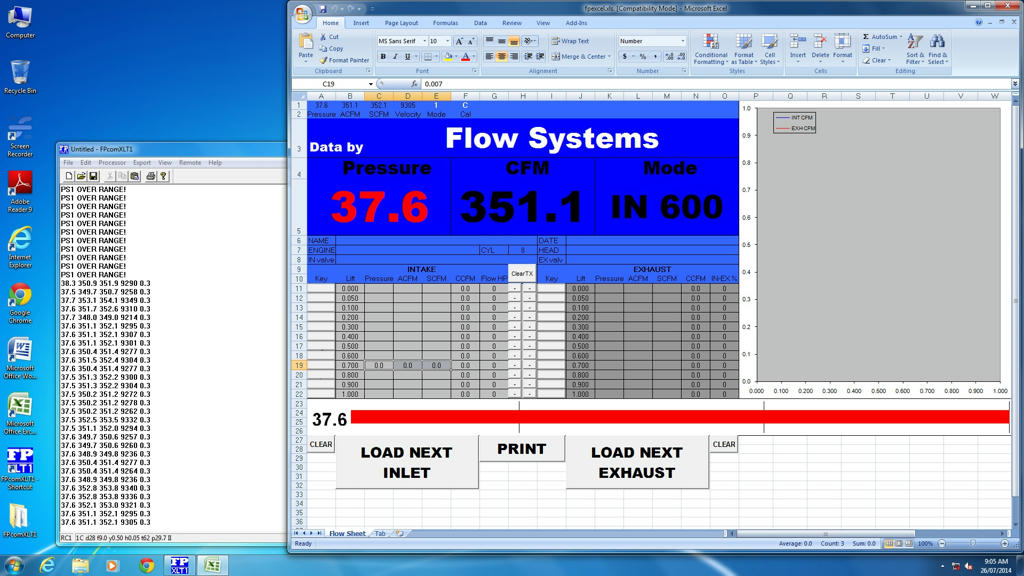

I was hoping I would save some work by not having to set up the 3.33" square edge internal orifice, but you sparked my curiosity so I calibrated it up (0.63 cd) and gave it a shot.
I'm now getting this with 6 motors, 8 motors over pressures the 40" sensor in the FP1
This is what I get with 8 motors
36.9 351.4 352.3 9302 0.3
38.8 358.4 359.4 9488 0.3
39.9 362.7 363.7 9601 0.3
PS1 OVER RANGE!
You're going to have to explain this one to me.
It took 15 minutes of cogs whirring but I think I know.
The larger orifice has less restriction so the motors aren't taxed as much - 28" + 16" = 44", were as now it's 28" + some lesser value like 10" so the total load is now only 38" -

If I recall the FP DM has 40" sensors on each range? So on a max range on a specific plate you are working with 28" + 40" = 68" Unless I'm missing something?
Also running the sensor up to it's max or over it's max will over time damage the sensor.

I am glad the experiment worked out favorably, thought it would i had talked to Bruce about this phenomenon a couple a month ago; He gave me the crooked eye stare then he happened upon it himself and we surmised that when you are pushing the internal plate to high 85-95% the motors start to work against each other. So it does prove we have to have specific ranges to get good efficiency from the bench with good numbers on the flow. I am thinking for what i do and i want to run some current draw tests on my bench that i can probably get away with doing everything i want and not strain the bench with a 425 internal plate.

So if I'm running 28" in the top chamber and I have an internal orifice so big that the lower chamber only adds lets say 5", my total load on the motors would only be 33", This should increase the benches flow capacity if the motors are in a more efficient area.
Imagine running 60" dep and only adding 5", this could be a way to maximise limited motor power. Your modern PTS DM shouldn't have a problem reading small stuff, but it now makes multiple orifices much more than just flow range changing.

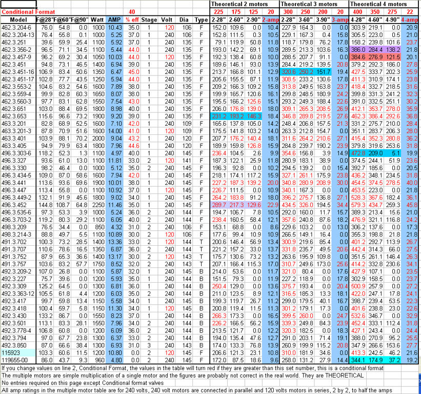

Any of you Pros want to decipher these motor specs, do you go for the dep at max air watts.
http://www.alliedelec.com/Images/Produc ... 259287.pdf
This is the Domel motor sheet I cobbled up in 2007 as a rough guide.
http://www.tractorsport.com/forum/viewt ... 3&start=30
It has every Domel at the time with the SF Ametek #115923 and the readily available over here Ametek #119655-00 at the bottom.
