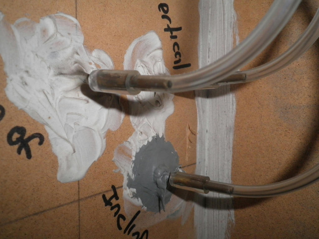

Here is my solution, a bit of soap and the next sized tube slid on.
